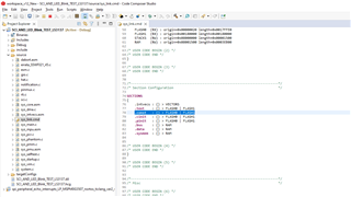

    I tried your approach already but the problem is with this approach the linker gives an error "cannot find file test.o".
    Please find the screenshot from a test project I created.
    I see the object file test.obj, I tried using and I have following warning.
    I think the approach is correct but I'm not sure why the const are not generated are they somehow optimised? (opt_level is Off and opt_speed is 1).
    Seems like I'm missing some obvious thing. it would be great if you can guide me. Thanks.
    Here is the test project I used
    .7127.TstMap.zip
