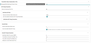

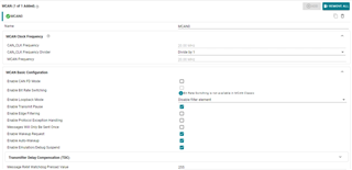

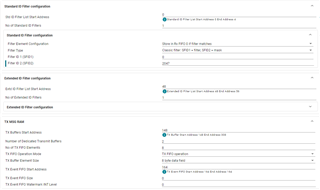

The CAN is configured to 1M bitrate, the configuration is shown below.
More information, at the beginning I though this might be a problem of the TX FIFO, so I did a experiment to TX message using dedicated buffer, the issue is the same.
