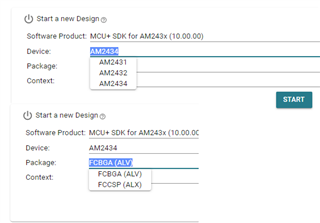

    Is your screenshot from the standalone tool version 1.21.2_3837, using the same SDK (mcu_plus_sdk_am243x_10_00_00_20) ,device, package and context selected?
    If I use version 1.2.1.2_3837 I get the following options for device selection:
    Here are the errors I get:

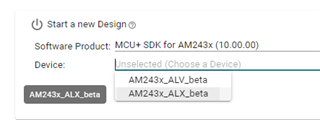

    But if I revert to version 1.20 I get these options.
    In version 1.20, the GPMC / RAM screen still gives me this error for AM243x_ALX_beta:

    In version 1.20, I can add a GTC device but there are no options, is this normal?

  • Hi Toby,
    I have checked with Device AM243x ALV, and the issue is not there.
    Today, I tried with ALX also as you mentioned and able to replicate the issue at my end. It looks like a bug in the SDK, I will file an internal Jira ticket for the same. Thanks for reporting this behavior.
    Yes, this is behavior is normal. Sysconfig support for GTC peripheral is not applicable. Please refer RELEASE_NOTES_10_00_00.

  • Hi Toby,
    I have checked the AM243x datasheet and found that GPMC/RAM instance are not supported in AM243x ALX package. So the above error related to GPMC/RAM is expected.

    Why does ENET CPSW page not work with ALX chip and latest version 1.2.1 sysconfig?
  • Hi Toby,
    I can see that you are using MCU+SDK version 10.0 for development. The Sysconfig version recommended with this MCU+SDK version is Sysconfig v1.20.
    Please refer SDK_DOWNLOAD_PAGE for info.
    Please note there might be compatibility issues with the newer version of Sysconfig as it has device data changes for AM243x device. It is suggested  to use the version recommended on MCU+SDK official documentation.
