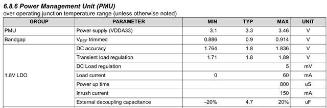

    Similar to the AM263P4 ControlCARD using VDDS18_LDO as the power source for the Clock Buffer(SN74LV1T34), I am planning to use VDDS18_LDO as the power source for the CMOS oscillator. The oscillator output will be connected to XTAL_IN (T1), and XTAL_OUT (R1) will be left floating.
    I intend to use the "ECS-2016MV-250-CN," which is expected to consume a maximum current of 3mA.
    In section "6.8.6 Power Management Unit (PMU)" in the SPRSP81C, I confirmed that the load current supplied by the "1.8V LDO" is a maximum of 60mA. However, I could not verify the maximum output current that the "1.8V LDO" can provide. so I am unsure if there could be any power issues.
    Could you confirm if applying the "ECS-2016MV-250-CN" would be acceptable?

  • DongHoon,
    If your maximum current consumption from the CMOS oscillator is 3mA that is ok. ECS-2016MV-250-CN is acceptable.
    If you are concerned, you can always use an external 1.8V regulator.
