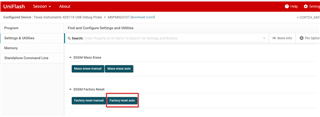

Hi Moon,
My customer recently found the issue when they burned the program:
This looks like two possible reason.
1. The SWD connection of the debugger is not correct.
2. The MCU running out of control, which break the SWD connection.
Debugger: XDS110
Several suggestions to check the root cause:
1. Check the connection: SWDIO;SWCLK;VCC;GND;NRST
2. Using the Uniflash to direcly connect the device, if there still has the issue, try below button to unlock the device (with XDS110 connected to the board):
B.R.
