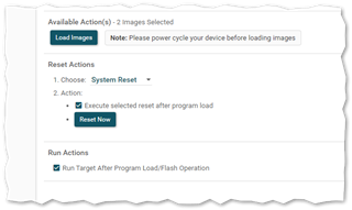

After flashing the EVM in 1S OSPI boot mode, the following selection doesn't do anything. At least it doesn't run the target:
To run the target I have to pull the power or press the PORz button.
How can I run the target "remotely" please?

  • Hi Nilabh,
    The requirement is for Run Target to work in UNIFLASH via USB.
    I just say "remote" because the EVM may be out of reach when deployed so I cannot press the PORz button in the case.

    Let's focus on the question. The assertion is that the UNIFLASH Run Actions are not effective. This is true even if I use DevBoot mode.
    you need to change the boot mode to OSPI boot mode
    The use case is that this EVM may be in an enclosure in a high voltage environment where I cannot change the boot mode switches so it must remain in 1S or 8S OSPI mode. Is this an unusual use case? I don't think so.
    My back up plan is to simply cycle the power but the UniFlash GUI offers the Run Target feature. I would like to use the feature. So the questions are:
    • DevBoot or not, why doesn't 'Run Target' work? Could I be doing something wrong?
    • If there is a technical reason why it doesn't work, what is the reason?
    • Is there a plan to address the reason for future UNIFLASH or EVM?
  • Hi Kier,
    Thank you for te detailed explanation, Now I am able to understand the issue better.
    The reset button in uniflash is not tied to device reset API yet. You will need to manually power cycle the board.

  • The reset button in uniflash is not tied to device reset API yet. You will need to manually power cycle the board.
    OK, understood. Thank you.

    It's not clear what you're showing me in your video. Anyway, reset is not the end objective. The objective is to run the program.
    Let's take a simple example. The LED blink project attached can be flashed in 1S OSPI mode. The LED does not blink after flashing if 'Run Target' is selected. It does blink after cycling the power.

    Hi kier Apologies for the delay, Run Target is not implemented, You would need to manually power cycle the board.

    I have created an internal ticket to track the same. Current estimate is to get it implemented by end of Q12025
    The thing I need to get a clarity is that in OSPI boot mode as soon as system reset happens the bootloader starts running there is not even a need to do run target, so I am inclined to believe that some how rest is not happening properly, Can you try the CCS IDE system reset to do that same.
