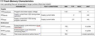

Regarding below picture, there is a note for endurance NWEC(lower 32kB flash).
Could you let me know which region is the lower 32kb flash ?

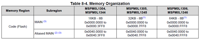

Seems like there is a note on the table 8-4 as following:
"First 32KB flash memory (address 0x0000.0000 to 0x0000.8000) has up to 100000 program and erase cycles."
But on the flash memory specs it is written 100k cycles endurance are only for lower 32kB.
Could you elaborate on this ?
