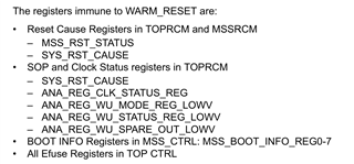

I wanted a register which value was kept even after issuing a warm reset.
I saw that MSS_BOOT_INFO_REG0-7 should be preserved, but the description says "Reserved Register for Software use" and has some weird values different from 0 that I did not put into it.
Can I use them for this use case? If not, are there any other registers that are preserved after a warm reset and that can be used by my SW?
