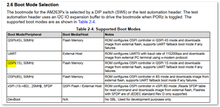

I am using UNIFLASH with sbl_ospi.release.tiimage with my multi-core applications in QSPI(1S) boot mode. It works well and the application runs. However, I don't really know what's happening behind the scenes.
Question 1: On the EVM there are two external flash devices. On which device is the SBL and .appimage flashed please?
