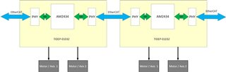

Dear TI experts,
we want to combine two TIDEP-01032 Dual Motor Controllers on a single board to build a four-axes controller.
To this end, we need to connect the two Sitara AM2434 by EtherCAT to have each of them operate as an individual EtherCAT node.
As this takes place on one board, we want to omit the PHYs between the two Sitaras and connect the RGMIIs back-to-back.

    1) Are there any recommendations on how to do this?
    • To be aligned on your requirement, can you confirm if the following image depicts the same:

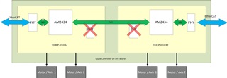

  • As this takes place on one board, we want to omit the PHYs between the two Sitaras and connect the RGMIIs back-to-back.
    We do not support PHY less connection between EtherCAT devices. You will be needing an external logic to manage link state as firmware needs this link state input to configure the ports correctly. Also without PHY, there will be reduction of 300ns in latency, and we can't predict the firmware impact due to this reduced latency.

  • Hi Aaron,
    thanks for your reply. Except for the two AM243x on the left and right, your picture is correct.

    Regarding your second answer, we are aware of the link state topic, but that sound like a problem that can be handled. What exactly does the SW expect to happen in this phase? Could we e.g. use the PHY_RESETn outputs of AM243x #1  and #2 to generate the link presence signal?
    Regarding the 300ns reduced latency: Isn't this a latency between two different SoCs? Is that a strong concern?
    Claus
  • Hi Claus,
    • Just to clarify, you are intending to not use PHYs on both the TIDEP-01032 as well as on both the AM243x EtherCAT SubDevices, right?
    • This 300ns refers to the PHY latency within a single SOC (between Rx and TX). Our implementation uses PHYs so we are not sure of the firmware behavior without this PHY latency handled.

  • Hi Aaron,
    please find a block diagram below to answer your question on the configuration.
    he first shows a 4-axes controller with two TIDEP-01032. This is where we come from:
    And this is where we want to go:
    As we need to have all this on one board, we want to remove the two PHSy in the middle (indicated by the two red "X")
    I hope that the image size is ok, I couldn't figure out how to format that or share files.
     Thank you and regards,
    Claus
