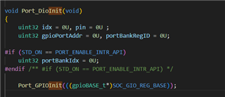

We are facing an issue when executing our application from Core2.
In below function SOC_GIO_REG_BASE can not be accessed by Core2 as per our test.
#define SOC_GIO_REG_BASE         (0x52000000U)
Is it right ?
We are getting kernel panic from OS. (We use Vector's Autosar stack)
From Core0 when we access this, there is no issue. Our application works fine,
This means MCAL 10.0.0 that we are using does not support multicore ?
Is this the limitation that MCAL can only work with Core0 ?
Request your kind support at the earliest since this is very much a critical issue for our project now.
