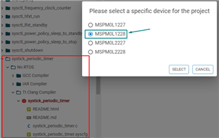

  • Hi Timo,
    Before doing that, could you confirm you're using the right SYSCONFIG file for your project? When you import a project, it's important to check if you're importing it for the desired target (like the picture below.)
    Diego Abad
  • Hello Diego,
    Yes, I have selected the MSPM0L1228 while importing the project.
    Timo

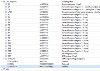

  • Hi Diego,
    I deliberately did not disable any interrupts. And the code examples are very small.
    The regular way would affect the mask flags, I think. Which is ok in the debugger. PRIMASK I have also checked, and it is not set. But thanks for that hint.

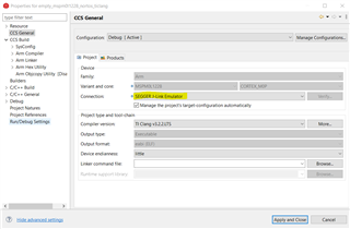

  • Hi Timo,
    What I mean by that is that when I try to run your projects, I encounter a J-Link error. That is most likely due to the fact that I'm running the projects you sent (configured for J-Link) with my XDS110 EVM. The original examples from our SDK do not show this error. Can I assume you modified your project to use J-Link?
    Diego Abad
  • Hi Diego,
    yes, I have chosen J-Link for connection in the Project Properties.
    Do you think this could cause the problem?
    Timo
  • Hi Timo,
    Let me talk with the software team, and I'll get you back on Monday about it.
    Diego Abad
  • Hi Timo,
    I was able to replicate the error you're seeing. It happens only when I use the J-Link to program the MCU. We will work in the next release to fix this problem.
