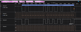

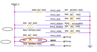

When connent the MSPM0L1306 launchpad with PHY EVM board.
We see that when read from PHY chip, when I/O is setted as input.DL_GPIO_initDigitalInput(MDIO_USER_MDIO_IOMUX);
When PHY wants to output the low signal, it cannot pull the voltage to GND.

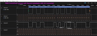

But when use the STM32 MCU connect with PHY EVM board.
