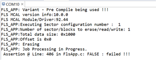

I am trying to run AM263P_MCAL_10.0 example on Eva Control Card.
I built Fls_App and run it on my Eva board, from the terminal output, it run successful.
If I change the Fls_Mode in Fls_Cfg.c from FLS_OSPI_RX_8D_8D_8D to FLS_OSPI_RX_1S_1S_4S, it gives error
So the question is how could I run QSPI mode on AM263P4 Eva board?
Our project used to run on AM2634 Mcu, we have set QSPI mode by: Fls_Mode = FLS_QSPI_RX_LINES_QUAD.
We want to run the QSPI mode on AM263P4 as the hardware design was not changed, so no OSPI connections.
