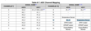

In ADC setting, If check "Disable channel 12 pin" mean use internal setting?
Is this automatically set as this?
ADC0 -> channel11 connected
ADC1 -> channel12 connected
Thanks.
GR
  • Hi, thanks for the question! The disable channel 12 pin can be checked if you want to keep that channel from being assigned to an external signal. This needs to be checked in the case you want to leverage the respective channel as the internal temp sensor input to the ADC. In short, if you want to read from the internal temp sensor with ADC1_12, this box needs to be checked to disable the pin resource. Hope this helps!
