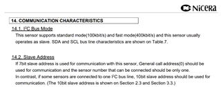

  • Hi Helic,
      Vendor just feedback us to read 0x00 is not a standard operation, should use 10bit address to read. Thus, there is no issue for
      general call address 0x00 on I2C bus to cause I2C_transfer stuck.
      But we still want to know how to do I2C BUS recovery (I2C_CMD_RECOVER_BUS) on freeRTOS when I2C_transfer stuck.
      It's because MCU has connected to 5 devices on one I2C BUS, and when we do stress testing (read/write data) on those I2C devices,
      somehow I2C clock pin stay in LOW permanently, and stuck in I2C_transfer as shown in below.
