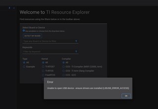

I still cannot get CCS to see the board. When I click on the detect board I sometimes get the below message
"Unable to open USB device-ensure drivers are installed (LIBUSB_ERROR_ACCESS)
I also tried running CCS in administrator mode and still it does not detect the board.
Any suggestions on what to try? I looked for USB drivers but did not see anything. Since device manager sees the XDS110 I assume the drivers are working.

    It could be an issue with my board. I have a sperate PC that is new. Its running windows 11. I downloaded and installed the latest CCS. It gives the same problem and does not see the board.  Or maybe I am using CCS wrong. I basically clicked on the "Browse and Import Examples" from the getting started screen.
  • I just realized my version 12 is not the latest version 12 even though the check for updates said there are no updates. So, I downloaded version 12.8 and selected the Hercules support along with many other processors. It still does not list the LaunchXL board as an option and does not see it when I check for board. I was able to create a project and select the RM46L852 chip on the board and setup a target config. I was able to compile some simple code and connect to the board.
    However, I have not found any Hercules example code anywhere.
    I was assuming I would be able to just plug my board in and get access to some simple sample projects.
