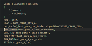

TMS570LC4357: How to Ensure .data Section Length is 8-Byte Aligned?
Part Number: TMS570LC4357
I'm trying to ensure the .data section in my CMD file is both start address aligned and length aligned to 8 bytes.
Here's my current setup:
While the start address aligns correctly, the length isn't 8-byte aligned. The linker output shows:
.data      0    f021a000    00001d0e     RUN ADDR = 0800e8a8
How can I make sure the section length is rounded up to the next multiple of 8 bytes? Any advice?
