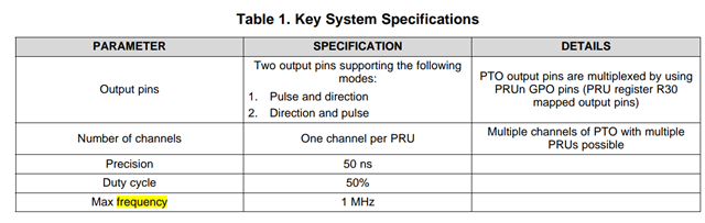

In AM335x, we have a below application note that describes how to perform high performance pulse train output (PTO) with PRU-ICSS.
High Performance Pulse Train Output (PTO) With PRU-ICSS for Industrial Applications.pdf
And it could achieve maximum 1MHz outputting pulse + direction.
Customer wants to the similar design on AM243, may I know if it is feasible or not, since we also have PRU in AM243?
The only difference is that customer outputs pulse + pulse not pulse + direction.
Customer is also wondering if they could achieve higher frequency greater that what we achieved 1MHz in AM335x?

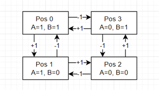

    We are trying to simulate A/B pulse output with this design. The current product is able to output at 5 Mhz.
    Jianyu
  • Hello Jianyu
    Thank you.
    Can you add some additional details.
    Sreenivasa
  • Hi Kallikuppa,
    The design is called Encoder Emulate Output(EEO), which is to emulate A/B signal when drive is using serial encoder like Biss-c, Tamagawa, etc.
    The customer can manually set the number of pulse per revolution.
    So we have PRU-A for EEO and PRU-B for Position feedback(Biss-c, Tamagawa,...). Both of them is synchronized with EPWM module.
    PRU-B will trigger interrupt every 62.5 us after new feedback is arrived.
    Once this interrupt is triggered,  R5F would calculate the position difference with direction. R5F will write 2 parameters(number of pulse and direction) to PRU-A.
    PRU-A would output that number of pulse at set direction when next interrupt of EPWM arrived.
    Jianyu

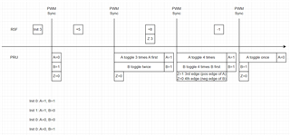

    One extra function I would like add for EEO, is EEO-Z for index signal.
    R5F core would write 3 parameters,
    1. Enable register, means there is an index at next cycle.
    2. Delay count, means after delay count of pulses, GPO19 is set.
    3. Manual high,
         - 0: Index is set for 1/4 pulse width of A and B.
         - 1: Index is set until this param is reset. This setting is used for controllers that require the signal to stay set for certain X ms.
    Jianyu

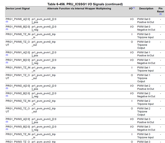

  • PRG1_PRU0 is both used for Biss-c / Tamagawa encoder and EEO output
    Unfortunately, this is not possible to do any sort of GPO output when 3-channel peripheral interface mode is configured for PRG1_PRU0.
    So, in this use case, you can switch between BISS-C/Tamagawa to EEO output (i.e. no need to run them simultaneously)?
    For simultaneous use, only potential alternative is to use PRU_ICSSG PWM Module for pulse generation (assuming IEP0 usage is consistent), so you will need to pick couple of PRG1_PWMx_A/Bx and one of PRG1_PWMx_TZ_OUT or PRG1_IEP0_EDIO_DATA_IN_OUT[31:28] for Index signal.
  • I checked with pinout, so we are using AM2431-ALV.
    IEP0 is currently configured as 200Mhz. Encoder and EEO would be used simultaneously.
    So AA9 and Y9, orignally PRG1_PRU0_GPO14 and PRG1_PRU0_GPO15, when configured as PRG1_PWM0_A1 and PRG1_PWM0_B1, can be used as EEO A/B output?
    And W7 when configured as PRG1_PWM0_TZ_OUT, can be used as EEO index?
    Jianyu

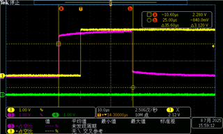

    Here is screenshots of EEO output from our current product. The pulses per revolution is 80000. Yellow, green, orange is A, B, Z respectively.
    1. Index signal when V = 60 rpm. MCU writes 5 pulses in every cycle. Each pulse width should be 6.25 us, and index pulse width should be 3.125 us.
    Also, A/B starts alternately in each cycle due to the odd number in each cycle.
    2. Index signal when V = 600 rpm. The pulse width for A, B, Z should be 10 times smaller compared to V = 60 rpm.
    3. When manualled index mode is on, PRU would still set phase Z after the set number of pulses. The index is reset when core reset the register.

    Here is an update on pin selection. We want to use V21 PRG1_PWM2_A2, R16 as PRG2_PWM2_B2, and U12 PRG1_PWM2_TZ_OUT for EEO A, B and Z.
    Jianyu
  • Hi Jianyu,
    It is possible to control PRG1_PWM2_TZ_OUT from PRU meeting the conditions you mentioned previously, but all PWM channels corresponding to PWM2 will go to trip state, But I will discuss with the team internally on this whether there are any alternative ways to avoid this.
    Below are the two other options:-
    1)Either we can use PRG1_IEP0_EDIO_DATA_IN_OUT[31:28] or PRG1_PWM1_TZ_OUT, PRG1_PWM3_TZ_OUT, PRG1_PWM4_TZ_OUT as EEO Z.
    Thanks & regards,
    Manoj.

  • Hi manoj,
    Here is some picture for small pulses examples in positive direction. Our current product updates every 31.25us. In AM2432 the planned frequency is still 62.5us.
    Yellow line is A, purple is B, green is z.
    This is a 3 pulses example. Note that our FPGA has filter so that 2 pulse is output in first 31.25, then the 3rd pulse at the start of next cycle. The output of A stays high and B stays low until new pulses arrived.
    This is a 5 pulse example with index.

  • This is an example timeline of data exchange between DSP and FPGA. I wish similiar implementation can be acheived.
  • Hi Jianyu,
    --> Initial state of the motor
    get abs position value or mod position value is written by R5F
    A,B signals should get stopped at that position.
    Index signal is disabled.
    --> when motor is rotating
    Direction configuration is always w.r.t to B
    position 0 is always 1,1 in both positive and negative direction
    To generate index signal after delay count
    go to position 0 and keep subtracting delay count
    if delay count value is zero then generate index signal aligning with A signal
    Should support Switching states between initial and motor rotating.

  • Based on the discussion we have. I'll summurize the feature request.
    1. PRU maintains s32_abs_pos_internal internally. Default is 0.
    2. s32_abs_pos_input for R5F to write.
    3. u16_Index_delay and u16_index_high for R5F to write.
    4. Every 62.5us, PRU receives sync signal from PWM of R5F. PRU may latches s32_abs_pos_input,  u16_Index_delay, u16_index_high at fixed delay after sync signal, R5F should update the variable after sync and before latch.
    5. PRU would calculate s32_abs_pos_input - s32_abs_pos_internal after the latch to get the number of pulse and direction. It would start output by the start of next sync signal, based on the state machine I shared. Note that we are ok if it is just a fixed delay time, not necessary synchronized with next sync.
    6. u32_max_delta_pos, maximum pulse difference value, which is used to block the pulse output if difference value is greater than this. By default u32_max_delta_pos = 250 since 250*16000 = 4M. We may increase the value if the demo is capable of higher frequency.
    When the differenct is greater than u32_max_delta_pos, PRU would only output x pulse to change its A/B output to match the position x. say s32_abs_pos_internal = 0 and s32_abs_pos_input = 0x1001, PRU would output 1 pulse in positive direction to match the state.
    7. For index, u16_Index_delay indicates how many pulses that Z is set. It now must adust the case that Z cannot be aligned with B. Let me know about the actual implementation in positive and negative direction.

  • I assume you need a separate variable like u16_ab_phase_state = s32_abs_pos_internal & 3 to determine the actual state.
    s32_abs_pos_internal should be same as s32_abs_pos_input after the calculation. The C code should be like,
    XXX_isr()
      u16_ab_phase_state = s32_abs_pos_internal & 3;  // 4 state  (1, 1), (1, 0), (0, 0), (0, 1)
      s32_delta = s32_abs_pos_input  - s32_abs_pos_internal;
      s32_abs_pos_internal = s32_abs_pos_input;
      if ( labs(s32_delta) > u32_max_delta_pos)  // Check maximum difference
        s32_delta  = s32_delta%4;
      outputpulses(u16_ab_phase_state, s32_delta);
