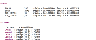

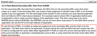

2. From the document, MSPM0 Bootloader (BSL) Implementation (Rev. C) :
     It seems that the document didn't tell how to create the second project for application, eg. how to specify the start address for the linker and etc.
     Can you help to provide more info about this?
