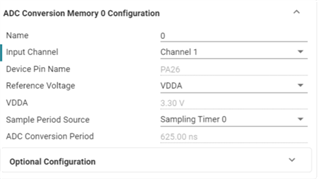

I'm doing my first steps with the MSPM0C1103 in the SOT-16 (DYY) package. So far I have set up an empty project in CCS. Now I'm trying to configure pin 1 (PA26, A1) as ADC input via SYSCONFIG - Software Tab - MSPM0 Driver Library - Analog - ADC12. When I click "ADD" the ADC12 configuration screen opens immediately showing an error mark and an error text "Instance limit has been reached".
It seems to me that for  the MSPM0 Driver Library SYSCONFIG is only able to configure ADC channel 0, which is "hardwired" with PA27 and which is not available at the SOT-16 (DYY) package. As far as I can see, in the SOT-16 package I should be able to use ADC channels 1, 2, 3 4, 5, 7 and 9. But I cannot find a setting in SYSCONFIG where I can select the ADC channel which I want to configure.
Am I doing something wrong or is it perhapts a bug in SYSCONFIG? My SYSCONFIG version is 1.21.0.
