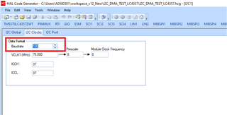

Hi Francois,
Are you using HALCoGen for your application to generate driver level code or not?
I am checking this because, if we use HALCoGen then we no need to bother about in between values instead of we can just directly give the required Baudrate at below box:
It will automatically calculate all the values.

I have written the driver level code for the product project, which show the issue.
I have generated a new project with HalCoGen, and using files and values, it show the same issue regarding I2C baudrate.

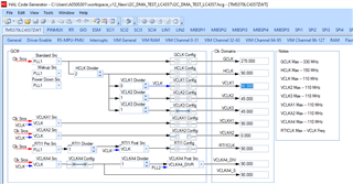

Hi Francois,
As i mentioned previously i don't have this board. So i took another Hercules board (TMS570LC4357).
For this board i took one existing I2C example and i configured the baudrate as 400Kb
Here i noticed one interesting observation:
Here is the I2C waveforms with 400K baudrate at VCLK 75Mhz:
Here is the I2C waveforms with 400K baudrate at VCLK 90Mhz:
When i configured 75MHz VCLK to the I2C module then i don't see any issues in the generated baudrate(i mean i got 411K baudrate), whereas when i configured 90MHz VCLK to the I2C module then the generated baudrate is not correct (i got 2.4K only).
And also, i noticed that in 90Mhz case also the prescaler and CLKH and CLKL dividers set to the correct values only.
Maybe i am suspecting this, the input frequency 90Mhz to the I2c instance is may does not support by the module. I will do further analysis related to this to confirm it. And mean time i am suggesting you try with 75Mhz VCLK and test it on your end.
