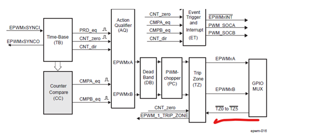

I am working on the sigma-delta examples (sdfm) with Motor Control SDK 09.02.00.11 looking at the Fast Detect and Over-current Comparator having some questions:
How can I use those units for generating a Trip event for the AM24 ePWM units?
What settings are required to route the corresponding events (internally) to the AM24 ePWM Trip Zone inputs?
