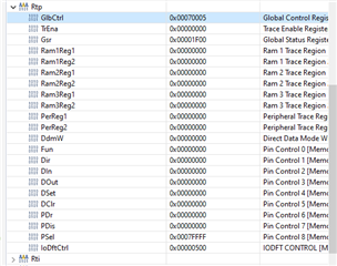

    For Example:
    Here is the initial values of RTP after reset of the controller.
    Now i wrote the 0xA to the lower nibble to enable the tracing:
    Here the value successfully written to it.

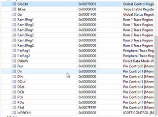

    Now i am writing Logic-1 to the 7th bit to reset the state machine:
    As you can see the state machine got reset and our trace enabled value came back to 0x5.

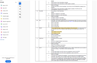

  • Hi Max,
    No, i don't see any issue with the description related to this bit in the TRM.
    Here they also mentioning that this bit will reset the state machine and register values.
    And also, there is another ON/OFF bit, so after doing ON or OFF, they are saying we can use this reset bit to clear the FIFO data.
