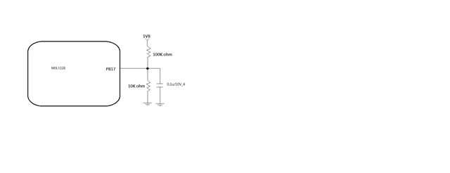

Hi team,
My customer use ADC to read the voltage value and find out the ADC read values are unstable. Below list their test results. Please help clarify if these results are reasonable ? or any suggestion can improve the accuracy ? Thank you.
HW block diagram:
Test 1, at 25 degree Celsius:
by Multimeter ADC read value ADC convert to voltage Delta
0.162 484 0.165429688 2.12%
0.162 471 0.160986328 -0.63%
0.162 483 0.165087891 1.91%
0.162 470 0.160644531 -0.84%
0.162 496 0.16953125 4.65%
