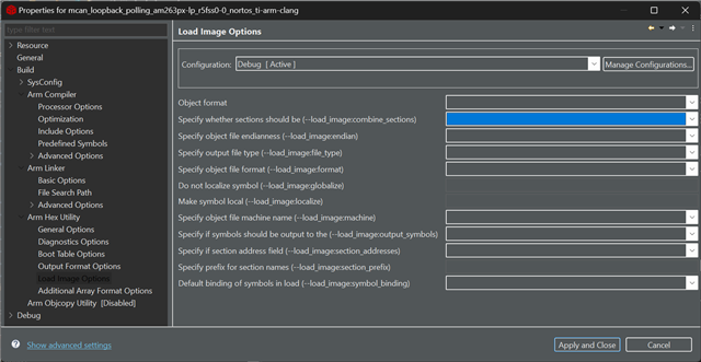

  • Also,
    I need to select options in this window, otherwise IDE won't go for creating mcelf file.
    What options to be selected in this?

  • Hi Sunil,
    Since you mentioned it is building without issues in command prompt but throws module not found error in CCS, I think it could be because the python used by CCS might be different. Could you enter this command in both command prompt and CCS local terminal and check if version is same?
    python --version
    Also check if pyelftools is installed in your current environment by entering this in CCS terminal. It should list pyelftools along with version in the output:
    pip freeze
  • pip freeze gave me:
    construct==2.10.70
    pyelftools==0.29
    python --version, I added this in bootimage_gen file and it gave me
    Python 3.12.3
    But where python is giving me 3 locations. Do I need to uninstall other versions of python?
  • What is python version in the command prompt where you said build is working?
  • Python 3.12.3
  • Does the CCS environment PATH variable have the same python used by your command prompt?
    You can check by right click on project --> properties then expand the PATH variable. This path should be same as output of where python from command prompt.
    Also please send your project as a zip. That will help confirm if it is really an environment issue or project issue.
    Thanks.
  • hello_world_am263px-cc_r5fss0-0_nortos_ti-arm-clang.zip
    I am unable to see the environment tab. I am using CCS  Version: 12.8.1.00005.
    I added the PATH variable in Linked Resources tab with python file location. Still same error "ModuleNotFoundError: No module named 'elftools'".
  • Hi Sunil,
    I have confirmed there is no issue with the project you sent, it is to do with python setup in CCS in your system. I will loop in a CCS expert who can help with this. Until then please proceed with the makefile build flow generated .mcelf binaries.
    Thank you.
