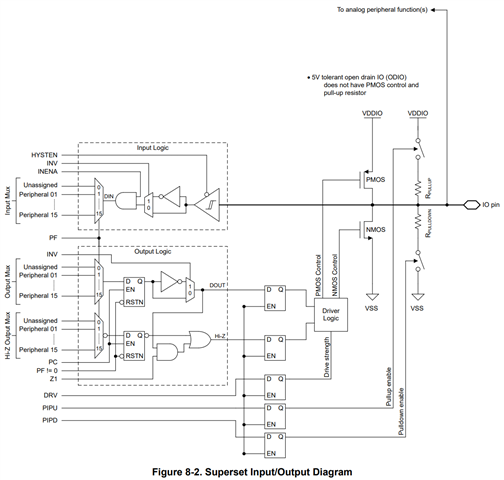

Is it possible to set the I/O of the MSPM0C1103SDGS20R to HiZ (both P and N are off) and L output (P is off, N is on)?
I looked in the TRM and found a Bit named HIZ1 in the GPIO configuration register.
Is this bit enabled only for 5V tolerant IO PA0, PA1?
If this is valid for all IOs, I could read that other IOs can be open-drain with this bit.
Ito

    You can configurate normal GPIO to Hi-Z mode.
    Please use below API to change to HI-Z mode. In this mode GPIO is like open-drain, and you can use external pull-up resistor to output high voltage.
    DL_GPIO_initDigitalOutputFeatures(GPIO_GRP_0_PIN_0_IOMUX,
    		 DL_GPIO_INVERSION_DISABLE, DL_GPIO_RESISTOR_NONE,
    		 DL_GPIO_DRIVE_STRENGTH_LOW, DL_GPIO_HIZ_ENABLE);
    Use below code to change to use internal pull-up/pull-down resistor mode, which is you said normal output mode.
     DL_GPIO_initDigitalOutput(GPIO_GRP_0_PIN_0_IOMUX);

    No, I mean if you set to Hi-Z mode, the GPIO will be used like open-drain.
    But if you want to output high voltage while in Hi-Z mode/open-drain mode, you need to use external pull-up resistor, which is the open-drain features just like PA0 and PA1.

  • Also, you can use internal pull-up as HI-Z is enabled.

    For 3.3V output, is an external pull-up resistor necessary?
    Ito
  • Hi Ito,
    You can enable internal pull up resistor which is 40k. Also you can use external pull-up resistor~
