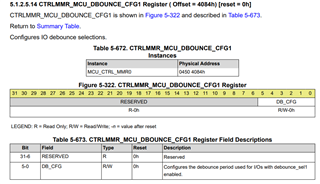

I tried to configure CTRLMMR_MCU_DBOUNCE_CFG1 as shown in the TRM but the value inside the register doesn't change.
i used HW_WR_REG32(0x04504084, 53)
0x04504084 - address of CTRLMMR_MCU_DBOUNCE_CFG1
53 - some value from the table
I also tried to unlock all the register with the KICK mechanism and verified its unlock but still when i read CTRLMMR_MCU_DBOUNCE_CFG1 the value shows 0.

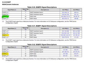

Hello Yoav Karmi
Please refer below:
The Signal Descriptions section of the device datasheet details which signals have debounce capability.
Note that debounce is based on signal, not pin/ball. Not all instances will have the same debounce capability
For example, EQEP0 has debounce option on all signals. However EQEP1/2 have debounce on all signals except EQEPx_I
