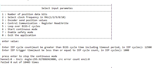

  • Hi Karl-Heinz Fischer,
    I checked it's working with 16 KHz position cycle
    Can you cross check if you have entered correct IEP cycle count here?
    I will just write the steps for calculation in case of ambiguity
    1. convert your cycle frequency into period ( 62.5 us in this case)
    2. IEP is running at 200 MHz which makes the period ( 5 ns)
    3. Divide period in step 1 with step 2, result will be 12500 steps as you can see in the image.
    I hope this answers the question.
    Best Regards
    Arnav
  • Hi Arnav Raj,
    (1)  In your answer, you are using the example program with the selection
    "6 : Start continuous mode", where a cycle length is then requested
    in 5ns steps (12500 steps --> 16kHz cycle).
    Here, a free-running, cyclic process is probably generated via the PRU itself.
    This then appears to run at 16kHz!
    (2)  In our case, we trigger one cycle at a time (currently via software (***),
    later via hardware!!!), but with a repetition rate controlled by us:
    ... and this is currently not running at 16kHz, but only at a maximum of 8kHz!
    (***) Triggered individually via software by calling the function:
          bissc_command_send(priv);      (from bissc_drv.c)
    We also call the default function for initialization:
          bissc_set_default_initialization(priv, icssgclk);     (from bissc_drv.c),
    just like in the example software in void bissc_main(void *args).
    (3)  So the question is:
    What else do we need to initialize (re-initialize) beyond calling
          bissc_set_default_initialization()
    so that the cyclic position evaluation via the cyclic call of
          bissc_command_send()
    also works with a 16kHz cycle?
    Thank you in advance for your efforts,
    Best Regards
    Karl-Heinz Fischer
