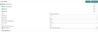

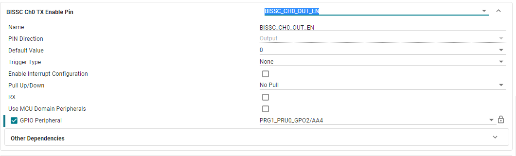

    2. Changes in examples\position_sense\bissc_diagnostic\single_channel\am243x-lp\r5fss0-0_freertos\example.syscfg file using sysconfig gui
        a) update the ICSS instance and PRU Slice
       b) update BISSC_CH0_OUT_EN & BISSC_CH2_OUT_EN GPIO pins as per the PRU slice & Instance

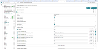

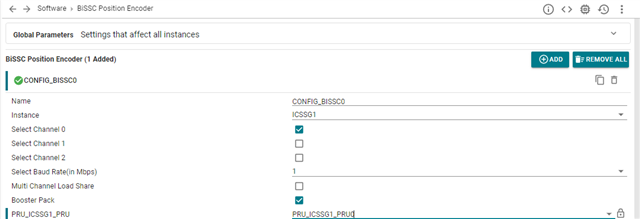

  • When you try to make the changes on your side it works? I find it very confusing when I'm just trying to make changes on your example project.
    Let me show you what I was doing:
    1. for the PRU Project:
    2. ARM project:
    a. SysConfig:
    Note - I had to leave BISSC0 because of your internal bug where you can't define ICSSG1 without defining ICSSG0 - I encountered the same issue before with the SDFM.
    b. code:
    Changes all CONFIG_BISSC0_xxxxx to CONFIG_BISSC1_xxxxx
    Change 'bissc_receiver_bin.h' to match the new output from the PRU project.

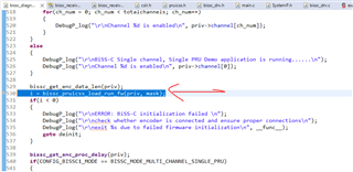

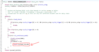

    This is where I get error:
    Basically - pruicss_xchg->cycle_trigger[0] is never 0.
  • Hi Ariel,
    Currently I don't have the requisite hardware to test for ICSSG1_PRU0. And I can't use the existing one due to pin out requirements.
    In answer to your sysconfig configuration when you add CONFIG_BISSC0 & CONFIG_BISSC1 both  two PRU_ICSS configuration namely  CONFIG_PRU_ICSS0 & CONFIG_PRU_ICSS1 for ICSSG0 & ICSSG1 respectively are created.
    PRUICSS_open() api in application c file is called with CONFIG_PRU_ICSS0 as parameter which you have to update to CONFIG_PRU_ICSS1.
    In answer to this I'm using sysconfig 1.20.0 and i'm not seeing this issue.
    can you crosscheck this again? are you not able to add instance as ICSSG1 in CONFIG_BISSC0?
