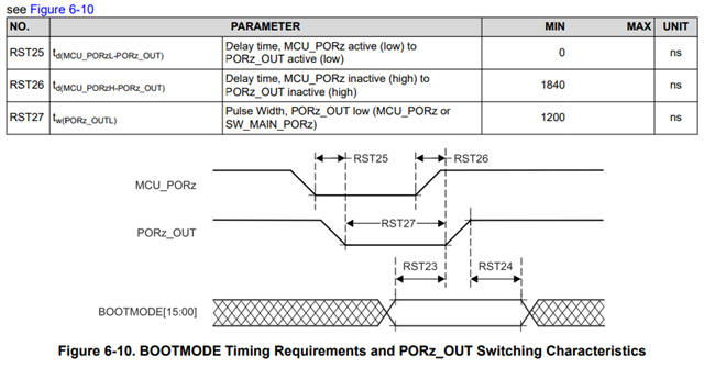

If the timing of the BOOTMODE signal does not follow the timing in the figure below, will there be a problem? The EVM circuit uses PORz_OUT to control reading the BOOTMODE signal

The BOOTMODE signals are latched at the time the PORz_OUT signal deasserted. There is potential for boot failure if SYSBOOT latching is not correct. If you have other peripherals attached to the BOOTMODE signals, they could cause conflicts with the BOOTMODE pull resistors and latch the wrong value. This is why the EVM uses PORz_OUT to control the isolation buffers and ensure other components do not conflict with the BOOTMODE settings.
