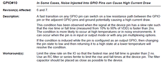

      Can you show a scope cap of the pin that is used? I suspect you are hitting this errata. Can you try the workaround suggested in the errata.
  • Hi Charles,
    Thanks for informing this errata info. We tried it by keeping RC filter (100 ohms series resistor and 0.1uF cap to Gnd) to all reqguired GPIO output pins. but still it didn't helped us.
