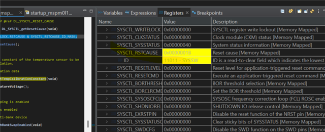

I am using MSPM0L1306 MCU and I am trying to test NRST triggered BOOTRST.
I am not able to see 0x0C value in RSTCAUSE register.
how to test this scenario?
How to generate below condition?
NRST (low <1 s)
Please help to generate NRST triggered BOOTRST reset.

    Assuming you are using CCS there is a way to launch the debug session that allows you to connect while the target is running.  See the attached pdf file which illustrates the steps.  Once you are connected to the target, perform a reset (NRST to GND) and view the RSTCAUSE register.  I see 0x0C.

  • Hi Dennis,
    I tried the sequence you mentioned in PDF. But i am getting SYSSW in RSTCAUSE register. Once I connect NRST to GND Its coming out of debug mode
    I am using
    IDE - CCS
    Debugger - JLINK
    Device - MSPM0L1306 (Custom board).
