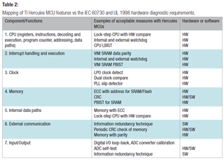

    I'm looking for the exact measures that we need to implement for each UL1998 requirements section.  The attached image and document is exactly what I need, but it refers to the Hercules.   Is there an exact mapping table for AM263Px?
    Ie.  I haven't seen LBIST capability on AM263 SDL documentation.   And unfortunately we can not run lock-step.
    Thank you.

    Unfortunately, we do not have any such data to support UL1998 compliance for AM263Px.Currently we only support IEC61508 standard.
    Sahana
