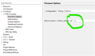

Now I saw a compiler option "silicon version" in the pru project settings.
The option offers five choices (from version 0 to version 4). Where can I see, what option my AM2632 controller needs/has?

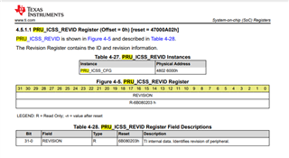

Can I read out a register to get this information?
In that context; I have found an information in the AM263x register addendum, which may be of interest.
What information/which bits in that register describe the silicon revision of the PRU core?
