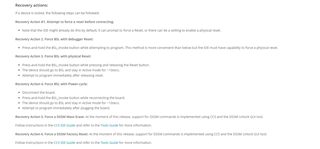

Hello Muhammed,
Take a look at Addendum B in the MSPM0 SDK FAQ for help. If the steps outlined in that section do not work, let me know which debugger you are using and if you have a connection from your debugger to the NRST pin on the target.
I am testing through the LP-MSPM0C1104 EVB. LP-MSPM0C1104 I am having this problem. not 1103. I opened the wrong subject name.
I see that MSPM0C1104 does not support BSL. When I look at the pin configuration I see that CCS does not support BSL for MSPm0c1104.
But I have tried all of them not working.I program the test kit directly via USB.
Hi Muhammed,
Ok, see attached instructions to run debugger scripts. See if you can run the following scripts "MSPM0_Mailbox_FactoryReset Auto" or "MSPM0_MailboxMassErase_Auto".
