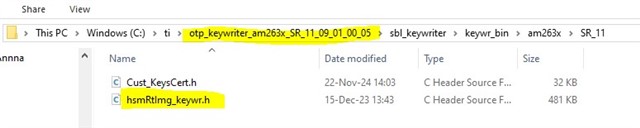

    There is a .h file of an HSM RT in the SDK. Is this a special HSM RT or does it correspond to the TIFS package?
    The size of the two arrays are different. He signed the HSM RT from the TIFS package with the TI Key.
    Regards, Holger
  • There is a .h file of an HSM RT in the SDK. Is this a special HSM RT or does it correspond to the TIFS package?
    This is keywriter hsmrt image, it is from OTP Keywriter. There is no relation between OTRP keywriter and TIFS SDK.
    I am not sure what is the question here? Why customer is trying to use OTP Keywriter binary on HSSE device.
    The extended OTP Programming should be done using the TIFS SDK example.
