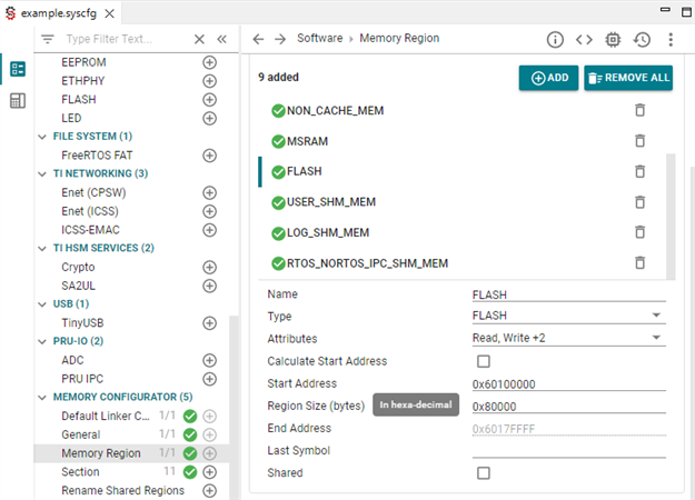

  • Hi Yoshihide,
    Are you referring to the FLASH region configured in example.syscfg file? Please refer below image.
    We are not using this section anywhere to keep any data or text. Hope this clarifies.
    Tushar
  • Hi Tusher,
    Thank you for your reply.
    Yes, that’s correct.
    I understand that it is not being used within the SDK
    Additionally, could you please tell me if there are any regions that cannot be used when the user side utilizes FLASH?
    Yoshihide Nagata
  • Hi Yoshihide,
    The FLASH memory above is reserved for the OSPI in DAC mode. This memory can only be accessed for reading not writing.
    Tushar
