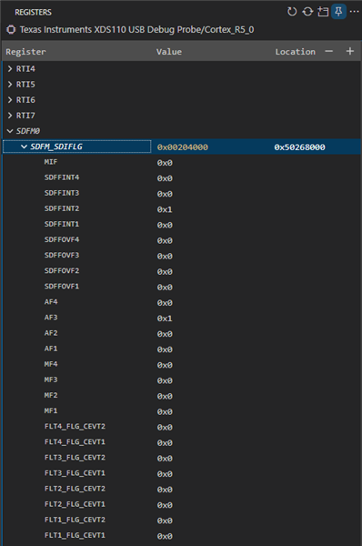

Regarding the files for Debug Registers:
This isn't working with new CCS2.0 isn't it?
it shows me the right value for the register, but when i look at the specific bits it just shows zeros.

Hello Marcel,
Apologies for the delayed response here. Are you accessing the register view while connected to the R5SS0-0 target or another debug target?
An update for the AM263Px device support xml file is being validated now and should be available as a CCS P2 update in early January.

Thanks for providing this information, can you include a screenshot of the About CCS screen or let us know what versions of the tool you are using? I am going to loop in an additional expert for further feedback.

Hi Zack,
My CCS 20 does not have those registers defined. I assume people still need to drop in some zip with the xml files that define it. I had tried this out last in CCS 12.x. There were various issues with the xml files. Is there an updated package?

Hey ki,
iam using the package of the linked question AM263P4: Peripheral Registers For Debugger.
Best regards
Marcel
Also when iam using the same package at Version: 12.8.1.00005 with the same setup connected, its working fine.
Zack,
This thread above is from 4 months ago. Is this the same version of the package that you provided to me yesterday?
