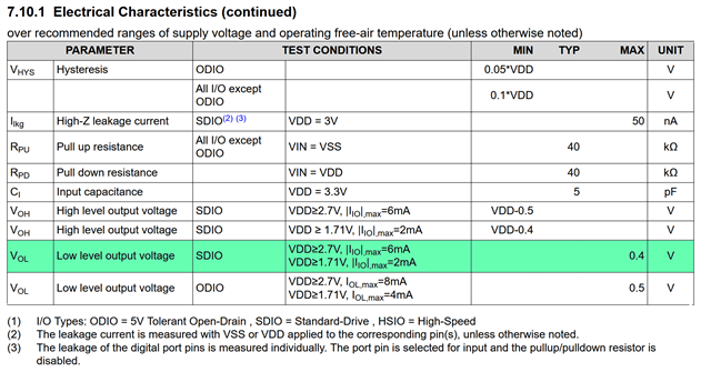

Hello MSP experts,
I have a question about the IO port on the MSPMOC1104. I want to switch a resistor through a port pin to GND. The supply voltage VDD is 2.2V .
In the datasheet I find the following information: VDD>1.7V Iio max =2mA with VOLmax = 0.4V
Do you also have the corresponding VOLmax value for me for an Iio max current of 3mA or 4mA?
