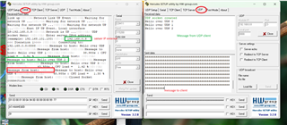

UDP testing:
UDP data is being received at server side but unable to receive data from server.
What are the functions to be called for UDP socket Open, send/receive data and close the socket, in the same TCP client App? We need to run both UDP and TCP to send/receive data on both the sockets at a time.
In the code section of UDP client:
  We did not receive the data to “gRxDataBuff “ sent from server:
           ret = lwip_recvfrom(sock, gRxDataBuff, APP_SOCKET_MAX_RX_DATA_LEN, 0, pAddr, &len);
            gRxDataBuff[ret] = '\0';
           EnetAppUtils_print("Message from host: %s\r\n", gRxDataBuff);

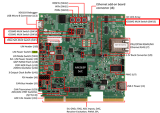

    1. I assume your AM263Px device has a label mentioning PROC# E2 revision. Can you please check the state of SW-14, SW-15, SW-16 switches on the board? Expected state for proper working for this example is OFF, OFF, OFF respectively.
    2. What bootmode are you in? I would recommend having SBL Null flashed to the device and running in OSPI boot mode. This is just to ensure the peripheral clocks are initialized properly. Sometimes there can be an issue with Gel scripts leading to incorrect clock configuration and ethernet packets not being received/ sent.

    1.  Yes, the labelling is PROC159E2.SW14 - OFF, SW15-OFF, SW-16 OFF.
    2.  DEV BOOT MODE

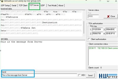

     At Server side: data is being received.

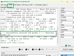

    when we sent the message from server "This is the message from Server", the following part of code should execute and display the message in serial window:
    File Name: app_tcpclient.c
    Function: static void AppTcp_simpleclient(void *pArg):
    code addded:
                    if (netconn_recv(pConn, &rxBbuf) == ERR_OK)
                        DebugP_log("Successfully received the packet %d\r\n", i+1);
                        //Below Line is Added by AVS
                        DebugP_log("Received Packet is: %s\r\n", rxBbuf);
                        netbuf_delete(rxBbuf);
      Why are we not getting the message ""This is the message from Server" in the "rxBbuf" though it is being received successfully.
    We are not able to see the message after Received Packet is                   .  it is displaying empty.

    • When I run the enet_cpsw_udpclient example from the SDK, I am able to see the message on Host PC sent by the AM263Px devices, and im also able to see message sent by Host to the AM263Px device.
      Have you tried running the standalone UDP client application?
