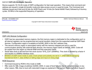

  • "OSPI controller supports only SPI mode 0  [bits 2:0](CPHA=0, CPOL =0) in SDR"
    This is not true. When power on the mcu, I could capture the SPI traffic on bus, which is running at SPI mode 3 (CPOL = 1, CPHA = 1). Which means RBL configured OSPI in mode 3.
    The issue is RBL cannot load code from ext flash at 4S mode. If as you said that one of your customer could boot in 1s-1s-4s mode, can we have the information of chip connections? As this is not related with our SW, it is about RBL.

    Hi Phoenix,
    Thank you for correcting me. Yes, ROM does configure in SPI MODE = 3 in case of OSPI (4s) boot mode. Section 5.4.1.3.1 OSPI (4S) Bootloader Operation in AM263P TRM  explains this. And on checking the value Bit [2:1] in Octal-SPI Configuration Register (0x53808000) it is 2'b11 indicating that it is in MODE 3
    Mode 0 and Mode 3 is supported in SDR and In DDR mode, supported SPI Mode is mode 0.

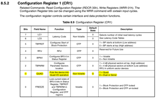

    One difference which was observed in SW is the Quad enable bit configuration in  MX25L3233F and S25FL128S flashes.
    S25FL128S have CR[1] as the QE enable bit (Non-Volatile). We would need to set this bit from applications before  the initial boot(for the 1st time).
    Quad Data Width (QUAD) CR1[1]: When set to 1, this bit switches the data width of the device to 4 bit -Quad mode. That is, WP# becomes IO2 and HOLD# becomes IO3. The QUAD bit must be set to one when using Read Quad Out (6Bh) command.
    Can you please try configuring the Quad Enable bit as per the commands provided in section 8.5.2 Configuration Register 1 (CR1) ,section 10.3.7
    Write Registers (WRR 01h) of flash datasheet and using STIG mode in OSPI as per AM263P TRM section 13.3.3.6.4.11 OSPI Software-Triggered Instruction Generator (STIG)

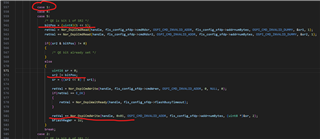

  • From the mcal Fls_Ospi.c, it shows the driver set the CR[1] to 1, so it should be cofigured correct.

  • Hi Rijohn,
    I have managed to perform a read of the CR1 register in flash and found that the quad enable bit is not set. I have also performed a write of this bit only and found that this resolves the issue and the SBL in now loaded in 4S mode.
    It appears that the SDK does not set the quad enable bit when running on this flash in factory default state. I have been configuring the flash driver in sysconfig to the same settings as used for the flash on the am2634 launchpad, so would expect it to be behave the same. Can you confirm on your hardware whether this bit is being set by the SDK and you're seeing the same fault?
