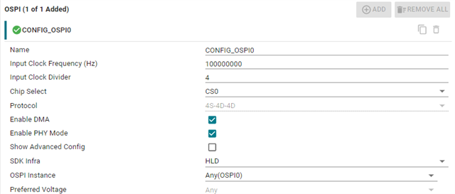

    I investigated it and found that problem is in auth process.
    After Disable Auth For Application Image in BOOTLOADER in SysConfig, it works OK.
    Could you suggest me any solution, please?
    This is a known SYSFW issue. It will be fixed in the next SYSFW release as part of the next SDK release.
    For now, you may continue to boot the application by disabling the authentication.

  • A few runs will be OK. Wait for more then 3 mins, do no to power off the device and reset it. After that device will crash on image auth. The red color will indicate problem, green success boot.
    Could you please change the OSPI settings in SBL as shown in the image and see if the issues still occurs?
    Thanks!
  • Hi, I changed Input Clock Frequency to 100000000, Enable DMA and Enable PHY Mode as you mentioned, and problem disappeared. Thanks, but could you explain my what cause this error and how frequency, DMA, and PHY Mode solve it?
    I try investigate the problem to understand your solution. I reduced changes to change Input Clock Frequency only and it solved the problem. But I can't still understand why? How it is connect with 3 min and why you suggested this clock value?
    I am not the OSPI expert. I suggested those configurations based on the SBL_OSPI bootloader configurations. The only explanation I have is the SYSFW may fail to incorrectly read the image from OSPI if it is not configured correctly. This incorrect read then leads to the authentication failure.
    BR, Prashant
