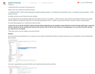

  • Hi Lee,
    Can you please refer the below recent thread once:
    (+) TMS570LS3137: Bootloader - Arm-based microcontrollers forum - Arm-based microcontrollers - TI E2E support forums
    Here also customer faced similar issue as yours:
    And here is the solution that i provided:
    Thanks & regards,
    Jagadish.

  • Hi Lee,
    I am having trouble with the transition to the IAR environment for the application, and I am struggling with the issues that arise during this process.
    Actually, i am not expert with IAR environment.
    I need to get some other colleagues help or else i need time to understand and provide my updates.

  • The interrupt vectors area of the bootloader is resolved by using the application’s vector addresses as follows.
    ; interrupt vectors
    resetEntry
    b _c_int00 ; _c_int00
    b 0x20024 ; vUndefAbort <-- app vector address
    b 0x20028 ; vSafeRTOSSVCHandler <-- app vector address
    b 0x2002C ; vPrefetchAbort <-- app vector address
    b 0x20030 ; vDataAbort <-- app vector address
    b 0x20038 ; phantomInterrupt <-- app vector address
    ldr pc,[pc,#-0x1b0]
    ldr pc,[pc,#-0x1b0]
    end
