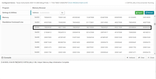

    yes, but when we debug a fresh Controller, the EEprom data shows maximum value.
    I have attached the image for your reference.
    The values shown are 0xFFFFFFFF. This means the EEprom is in erased state. This is the expected state of the EEprom when shipped as virgin devices.

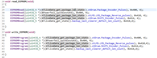

    Looking at your screenshot, it seems you are using some custom EEprom driver. Is that correct? If you are using a custom EEprom driver, you might want to check your driver if you have initialize the EEprom properly.
    Why don't you run a simple EEprom example as follows. Can you get this example to work?

    I have attached the our EEprom read and write function FYR.
    Thank you for your support and understanding.

    It appears that you suspect we might be using a custom EEprom driver. However, I would like to clarify that we are not using any custom driver.
    Ok. Thanks for the clarification.

    Our primary concern is regarding the initial state of the EEprom data. As you mentioned, a virgin controller should have no data in the EEprom. However, we found that the procured controllers contain data upon initial power-on. Attached Proof for your reference below
    Wait a minute! I think you have some misunderstanding. Are you using Uniflash to read the EEprom or the flash main array? Please bear in mind that EEprom is NOT memory mapped. You CANNOT read the EEprom contents using Uniflash. What you are showing in the image is that you are reading the main flash array at 0x400, not the offset address 0x400 for EEprom.  In order to read the EEprom content, your need to run your application to read from the specified offset address relative to the EEprom module. See below code. The address 0x400 shown below is NOT memory mapped in the CPU's addressable spaces.

  • Wait a minute! I think you have some misunderstanding. Are you using Uniflash to read the EEprom or the flash main array? Please bear in mind that EEprom is NOT memory mapped. You CANNOT read the EEprom contents using Uniflash.
        Understand, Thanks for the clarification.
    Like I said before our primary concern is regarding the initial state of the EEprom data. As you mentioned, a virgin controller should not have data in the EEprom. However, we found that the procured controllers contain data upon initial power-on.
    (note: we can read and write EEprom data . but the issue is VIRGIN CONTROLLER CONTAINS DATA IN EEprom, due to that, our code does not run due to our set of rules and sequence)
    We kindly request your assistance in suggesting an alternate method to remove EEprom data during the initial power-on condition.
