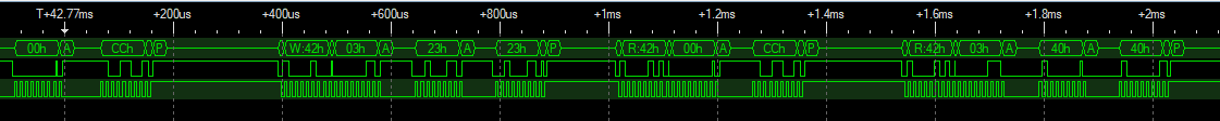

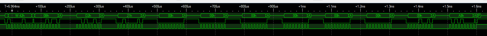

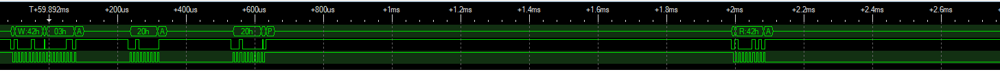

The following are images from my logic analyzer showing the successful communication of the steps above.  First the COMMAND_DOWNLOAD and then starting to read the ACK...
...and then the ACK response, and the status:
All of it looks good.

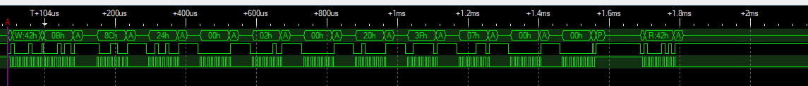

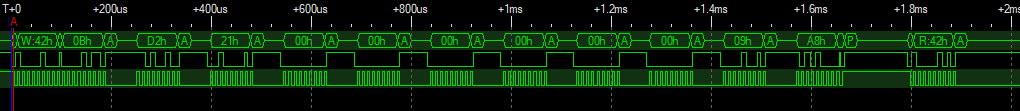

When doing the first COMMAND_SEND_DATA command it hangs indefinitely at step 2.  The bootloader never sends back an ACK no matter how long I wait.  Here's my logic analyzer output:
Now, here's the funny thing: If I omit the COMMAND_GET_STATUS when doing both the COMMAND_DOWNLOAD and COMMAND_SEND_DATA commands, everything works.  The entire 0x9A8 bytes of the new firmware will successfully get sent from the EK-TM4C129EXL to the EK-TM4C1294XL and written to flash on the EK-TM4C1294XL.  When rebooting, it successfully runs the new firmware.

    As far as I can see in the above waveform, you are sending:
    - byte length: 8
    - Checksum: 0x8C, Can you confirm if 0x8C is correct?
    - Command: 0x24 (SEND DATA)
    - Data:1 0x20000200
    - Data2: 0x0000073F
    After SEND_DATA is transmitted, you then try to read the response. You begin with "R 0x42". However, I do not see any more data being transmitted. Comparing to the working waveform, I see "R 0x42" -> "0x00" -> "0xCC", the non working waveform does not follow with the 0x00. I'm a bit confused with myself with this 0x00 the second byte. I believe this is supposed to come from the slave because master issues a I2C read command. I don't know why the slave is not responding. Can you issue a PING command to see if the slave is in bootloader mode or not?
    Yes, I agree the second (as well as third) byte is supposed to come from the slave.  This is where things fail and I get no more response from the slave.  To explain a bit more: My understanding of how the default bootloader works is when the master sends a valid command the bootloader will respond with an ACK.  This ACK consists of two bytes (0x00 followed by 0xCC).  If there is some issue the bootloader will respond with a NACK (0x33 instead of 0xCC).  Of course to obtain the ACK or NACK the master must do a read.  This is what is happening when you see the master send "R 0x42" - it's initiating the read of the ACK/NACK.  And you're correct, the first sign of a problem is when the master sends the "R 0x42" and gets nothing back...  And this is when everything fails and I no longer get any responses from the slave (i.e. the target).

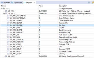

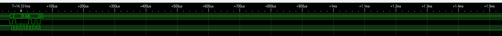

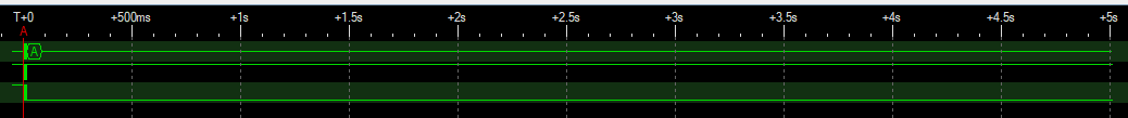

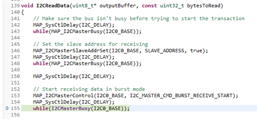

    It's hanging due to the master bus being busy after starting the read as shown below:
    The bus remains busy indefinitely:
    This is the same function I use to do all other I2C reads and have not experienced any problems....  I'm not sure why the bus busy bit remains set indefinitely...

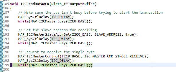

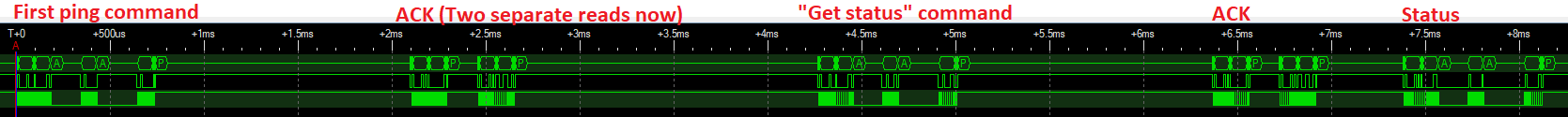

  • Okay, thanks, Charles.  I replaced the burst read with two I2C_MASTER_CMD_SINGLE_RECEIVE and am still getting the same results.  I also extended the I2C_DELAY to 6000 ticks to give the receiver more time, but also get the same results.
    Here's my new I2CRead function:
    #define I2C_DELAY                 6000     // Wait this many ticks between I2C actions
    void I2CReadDataACK(uint8_t* outputBuffer)
        // Make sure the bus isn't busy before trying to start the transaction
        MAP_SysCtlDelay(I2C_DELAY);
        while(MAP_I2CMasterBusy(I2C0_BASE));
        // Set the slave address for receiving
        MAP_I2CMasterSlaveAddrSet(I2C0_BASE, SLAVE_ADDRESS, true);
        // Request to receive the single byte
        MAP_I2CMasterControl(I2C0_BASE, I2C_MASTER_CMD_SINGLE_RECEIVE);
        // Read the first byte of data
        outputBuffer[0] = I2CMasterDataGet(I2C0_BASE);
        // Read the second byte of data
        outputBuffer[1] = I2CMasterDataGet(I2C0_BASE);

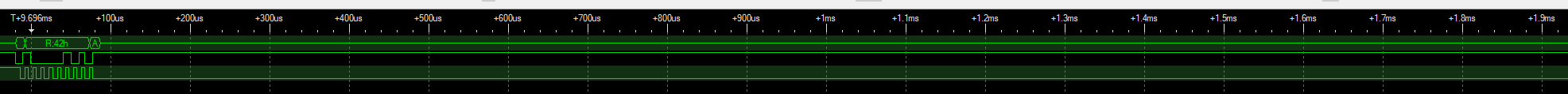

    Similar to my old I2CRead function, it gets stuck indefinitely here:
    The bus is busy indefinitely with SCL held low after the read attempt:
    Zooming out showing it hanging indefinitely:
    With clock stretching, it should be up to the I2C slave to release the SCL at some point, right?
    Also, I believe it is the target device (the I2C slave) holding SCL low since if I reset only that board without touching the other board (the master) the SCL line goes back high.

  • Also, I believe it is the target device (the I2C slave) holding SCL low since if I reset only that board without touching the other board (the master) the SCL line goes back high.
    Hi Terence,
      Can you double check on the master side by setting up a Clock Low Timeout? If you see the timeout flag or interrupt then it confirms that the slave was indeed holding the bus. As far as why the slave side ROM bootloader was holding the bus, I really don't know. As a matter of fact, I cannot recall ROM-based I2C bootloader questions on e2e. You might be the first one or one of the very few. Most people use UART, Ethernet and USB with some people use SPI and CAN. Since you are using the ROM bootloader, the visibility and debug into what it is doing is somewhat limited unlike the flash-based bootloader. When a slave stretches the clock, it means it is not ready to take the data. What if you send just 4 bytes or less at a time in your SENT_DATA command instead of 8 bytes? Will that make a difference? I will start with sending just one byte at at time to see how the bootloader responds and gradually increase the byte count.

  • Hi Charles, thanks for the reply.   Yeah, I can understand using I2C to communicate with the bootloader is not the common or preferred approach.  We have a situation where we're using a TM4C123 (so, no ethernet) and we're not using USB with it, and UART0 is not available for bootloader communication.  We do however have a separate processor on the same board that talks I2C to the TM4C123 on I2C0.  This separate processor can communicate with the outside world.  So, it (unfortunately?) made the most sense to use it for updating the firmware.
    I added the Clock Low Timeout as you suggested.  As the TivaWare documentation states:
    " ...to program a timeout of 20ms with a 100-kHz SCL frequency, ui32Value is 0x7d"
    I figured 20ms would be plenty so I used 0x7D as the timeout.  Here's the code that initializes the I2C master:

        MAP_I2CMasterInitExpClk(I2C0_BASE, sysClock, false);  // Set speed to 100 kbps
        MAP_I2CMasterTimeoutSet(I2C0_BASE, 0x7D);
    ^That code is the same as before, except that I added the I2CMasterTimeoutSet() at the bottom.
    Rerunning the exact same test as before shows the Clock Timeout Error now when it did not exist before:
    Seems to be additional indication the ROM bootloader is causing the issue.
    Good idea!  BUT then that made me think of trying something else: Just send pings (only a single data byte) endlessly once every 50 milliseconds and see if it can handle that.  Unfortunately, same issue:
    And then the ACK read on the second ping fails with SCL stuck low as usual:
    Despite this, I don't think it's a showstopper.  Like I mentioned before, if I don't send the "get status" commands the firmware update is successful every time.  I've tested this many times without fail.  Yes, it would be nice to have the status *but* I do at least have the ACK's for each command I issue.
    I will talk with others on my team regarding this, but I feel fairly confident this will be acceptable.

    Hi Terence,
      Thanks for the confirmation. The slave indeed is holding the bus for whatever reason that I don't have an explanation.
    Ok, I see. Perhaps there is some unknown issue with the ROM-based I2C bootloader. Since the bootloader is stored in the ROM, there is no way of patching it without a silicon respin which is not possible.
    Glad that you have tested the workaround (by not sending the GET_STATUS command) without failing. I will definitely take note of this and bookmark this post so anyone in the community can benefit from your workaround if I'm asked. Thanks so much!
