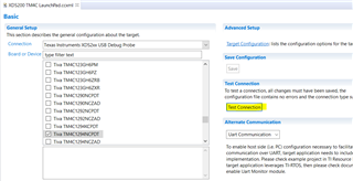

      Did the chip fail program/erase on the first try? In another word, did you have any success with program/erase before it started to show error?
      Can you show the error when programming failed?
      Which debug probe do you use? Do you have another debug probe you can try that can replicate the error?
      Can you run a JTAG scan-chain test? Below is an example using XDS200 debug probe to run a scan test. What is your scan test result? First run on a known good board to have a reference for comparison then try on your suspected board.
