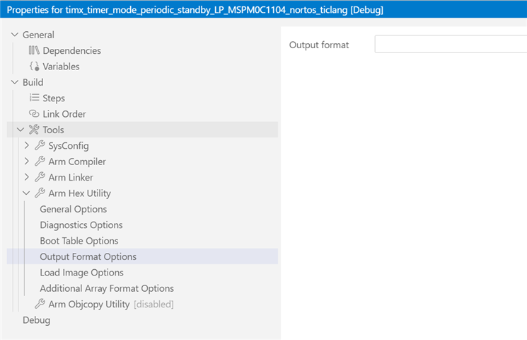

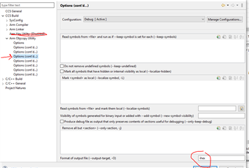

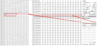

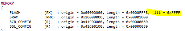

Hi sir,
       "How should I configure CCS Theia so that I get the correct bin file after compilation for burning, rather than having some data missing and shifted forward, as shown in the figure where the address 0x5050 is shifted forward by 8 bytes, which should be filled with 0xff?"
