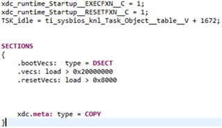

CASE-01:
#pragma DATA_SECTION(g_pfnVectors, ".intvecs")
<-------- Start -------->
program will not fit into available memory. placement with alignment fails for section ".resetVecs" size 0x3c , overlaps with ".intvecs", size 0x200 (page 0)
linker.cmd /CSL1601/Release/configPkg line 209 C/C++ Problem
<-------- End -------->

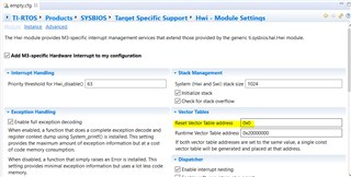

var m3Hwi = xdc.useModule('ti.sysbios.family.arm.m3.Hwi');
m3Hwi.resetVectorAddress = 0x8000;

    CASE-01:
    It seems like you are trying to set the Reset Vector Table address to 0x8000. Is that correct? The Reset Vector Table should be at 0x0. See below default. Why are you creating a new vector table? I also don't understand why sleep mode would require a new vector table and a new reset vector address. I strongly suggest you not change the vector table unless you really know what you want to accomplish would require doing do. You basically are taking away the default vector table the TI-RTOS is managing.
