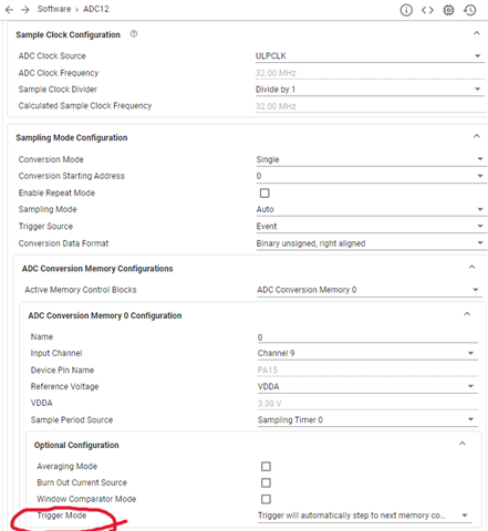

Sysconfig(see attached photo):
Use PWM to generate 1khz, 50% duty cycle square wave at PA3
Set comparator to use PA26 as positive input, internal voltage reference as negative input. generate event signal with DL_COMP_EVENT_OUTPUT_EDGE to trigger ADC
Set ADC to event trigger, single conversion, disable repeat mode, sample PA15

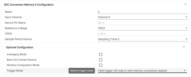

  • You need to change the trigger mode.
  • i changed trigger mode to "Valid trigger will step to next memory conversion register", the rest is the same with experiment 2. step 0 to step 3 produces the same result. anything else i can try?

  • Here is my syscfg file. Use ''valid trigger will step to next memory conversion register''

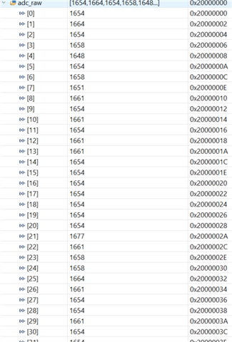

    here is my project that replicate the bug. if you connect PA3, PA15, PA26 together, remove jumper on J1 and J12, no other external circuit component involved. run the project for 7 second, it should stop and shows the adc_raw record value that jump between 3300mV and 0V.
